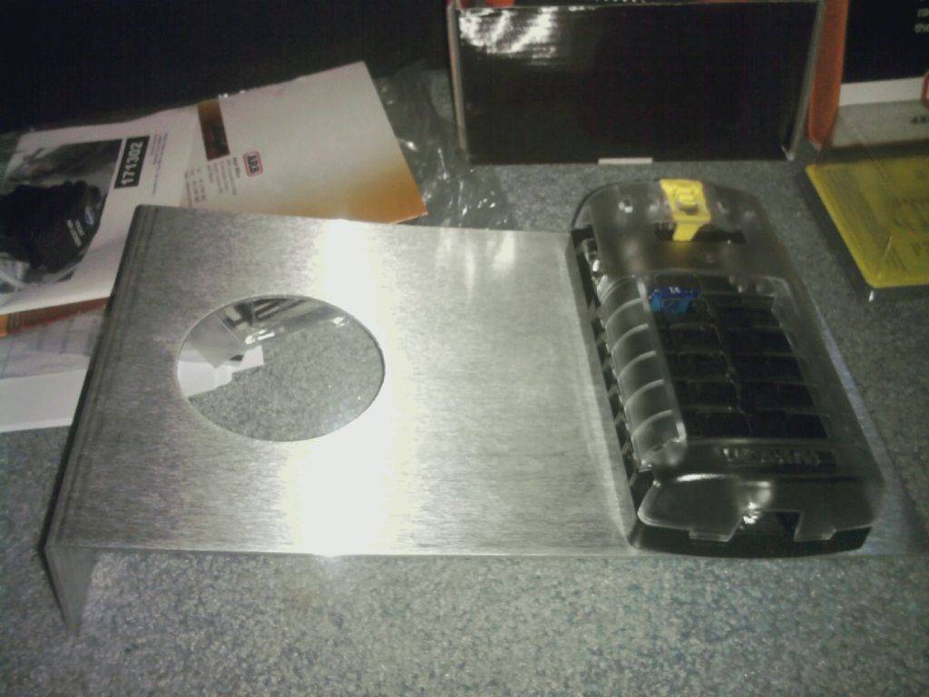

Been eying up and taking measurements for compressor mount as well as aux fuse box. Got two plates bent up at a local shop today.
First one is for the fuse box. 0.09 alum to save on weight since the fuse box is light. Had a hole cut out for access to the reservoir. It has slotted cutouts to mount to the stock reservoir mount as well.

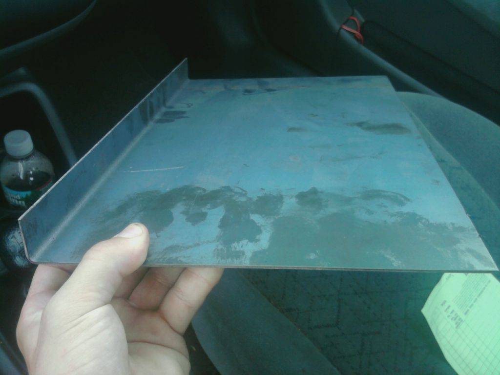

Second plate is for the compressor/winch solenoid mounting. 16 gauge steel with a 1" lip bent for extra stability and side mounting options in the engine bay.
This will sit in the engine bay on the passenger side wheel well. Just need to notch out an area by the wiring loom by the firewall so it slides back a bit further

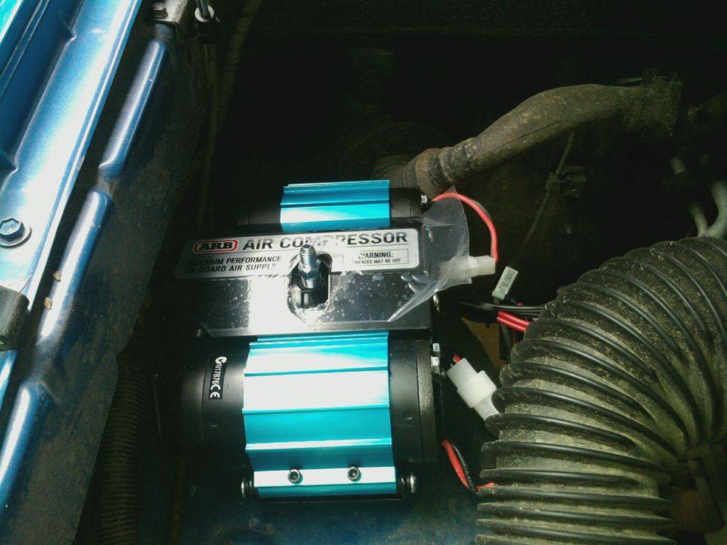

Here's what the compressor looks like just resting in the engine bay.

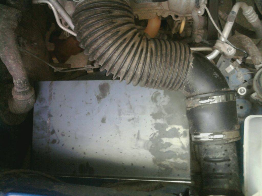

Got a 16 gauge plate of steel cut by my local fab shop. 10"x15" with a 1" lip bent on the long side to add a bit of rigidity
Here's the compressor just sitting in the engine bay for a bit of test fitting
Piece of steel I had made
Once that was all said and done I got to town taking some measurements. The bracket requires a bit of trimming to get around one of the grommets by the firewall, here it is all drilled out for the ARB mount

Sitting in the engine bay
Bracket primed and painted, don't mind my shitty rattle can paint job :o
Basically all the holes were eyeballed since I had no way to measure anything, it took alot of putting bracket in engine bay, marking the hole, drilling, rechecking, etc.
Here's the plate flipped upside down with the compressor mounted to it
Basically I utilized the two front bolt holes and bolts from the OEM air intake since my snorkel takes up a lot less space. If you don't have a snorkel I'm sure you could integrate the bracket into the OEM mount with a little more thought. The rear mounts through a grommet that is in the wheel well already, thank god for that or else there was no way to secure the back.
Requires a little contortion of the hands and lining things up but here's where the rear mount is
I had to rotate the bracket a bit to make it work. Sort of deviated from my original plan but there was no way to mount it to the studs since the ARB secures from the bottom and the studs would need to be tightened from the top.
I put some rubber bushings that came with the ABS bracket onto the unused studs so the plate will have a sort of dampened vibration.
I put a large fender washer that allowed for some misalignment and adjustment for the rear mount, the nut was really hard to get to I used a nylock and locktight to make sure it wouldn't come loose.
I had to use some metal spacers (sleeves) to level everything up but here it is all bolted up
For the twin ARB compressor it doesn't come with the manifold kit you have to purchase it separately and mount it. These two threaded holes lined up perfectly with the mount.
They use the same bolts that the windshield washer resi uses, M6-1.00 bolts.
Here it is all plumbed up, make sure to seal all the connections with teflon and/or thread sealant, we don't want any leaks now :)

I also mounted my aux fuse box and breaker today, that was much simpler, no writeup required lol

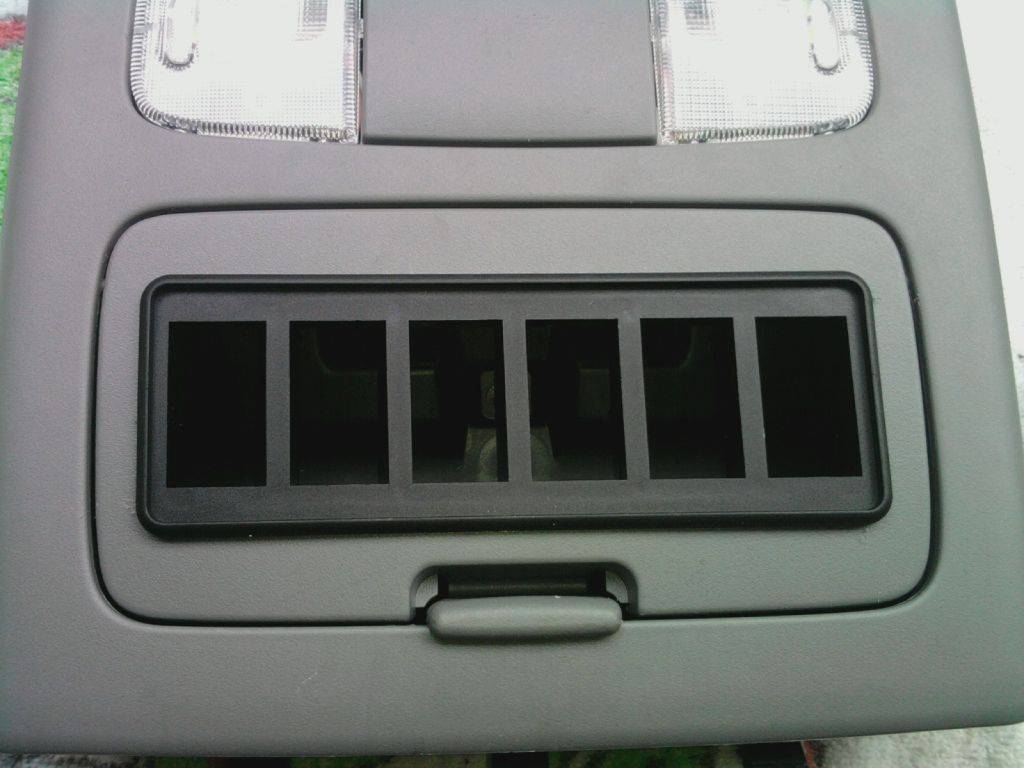

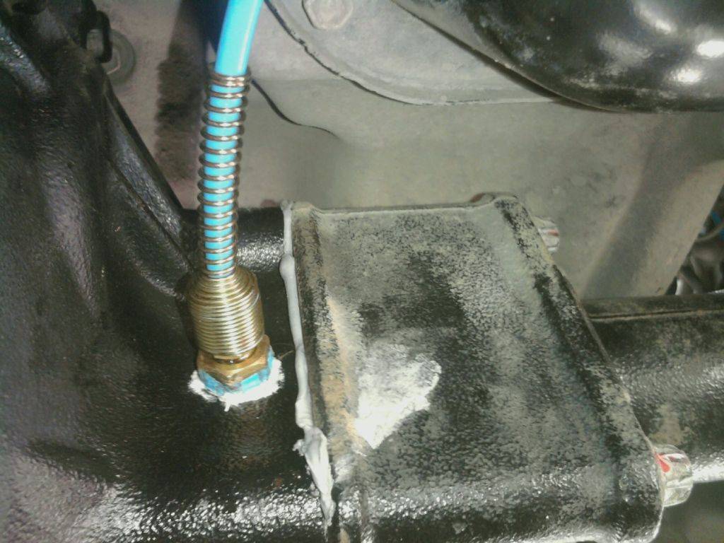

Got my 6 switch holder mounted today. Also hooked up the front air line finally lol
No more leaky after I put the thread sealant on there with a generous amount of teflon

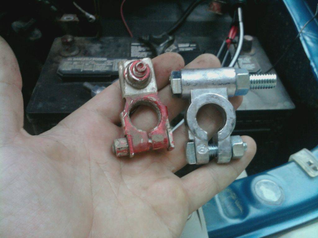

Got some new mil spec battery terminals. These will allow easy attachment to bigger cables for when I connect up winch, dual batteries, compressor, etc. Ordered some wire this week and will likely be redoing the battery connections and finishing up the wiring for the locker and compressor this weekend :)
Dielectric Grease!
Yep that is a must, gotta protect the bling. That fuckin tinned marine cable ain't cheap either. Ordered 25 ft of 1/0 AWG for extenting winch solenoid wire and 25 feet of 2 AWG for the battery connections. Between the lugs, cable, heat shrink and such I spent around $200.
