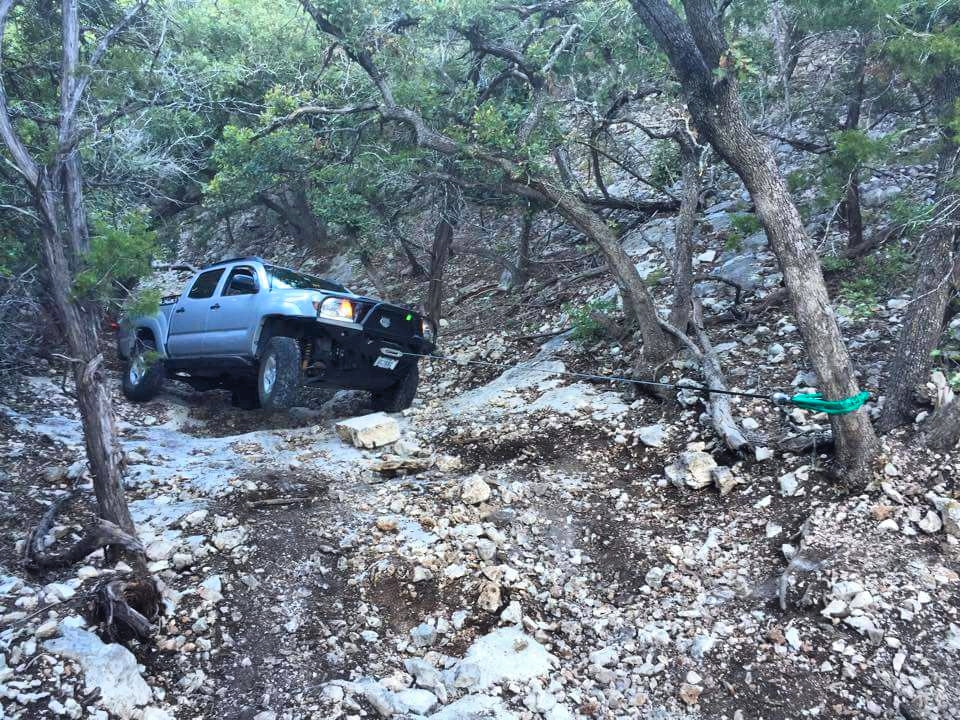

Trees Ranch

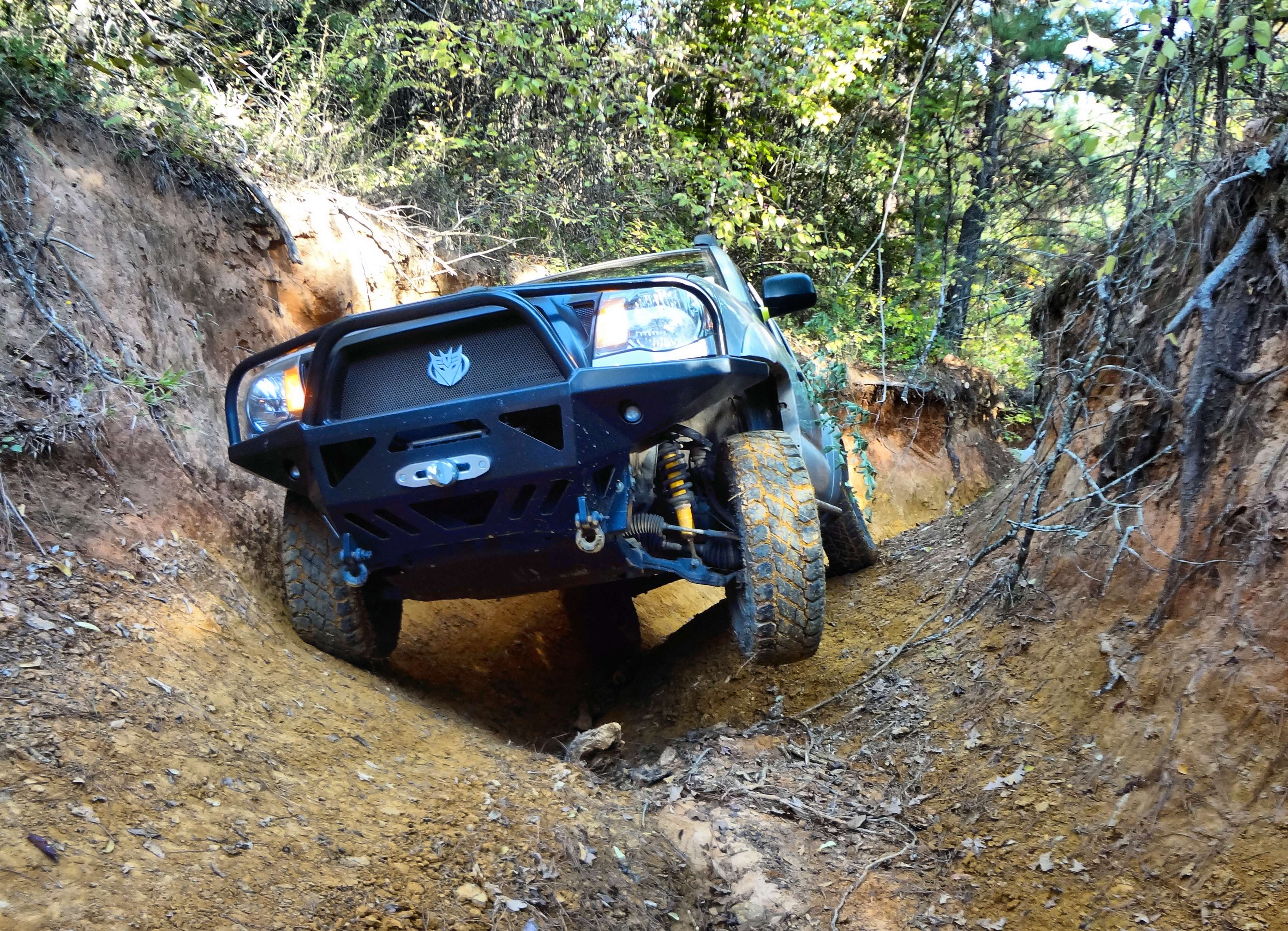

Barnwell Mountain

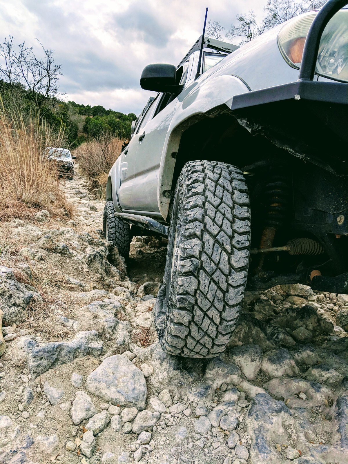

Big Bend Ranch State Park
