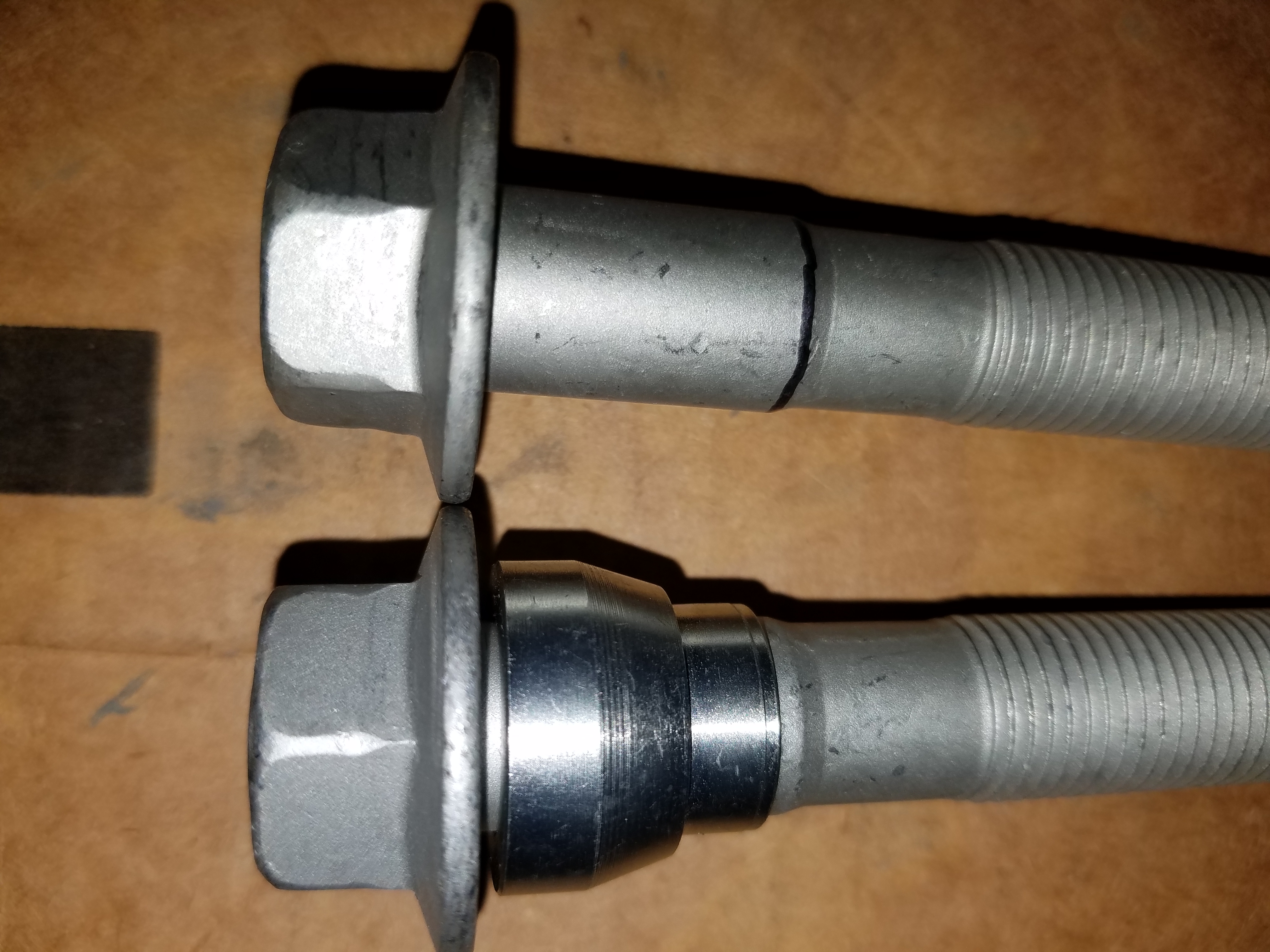

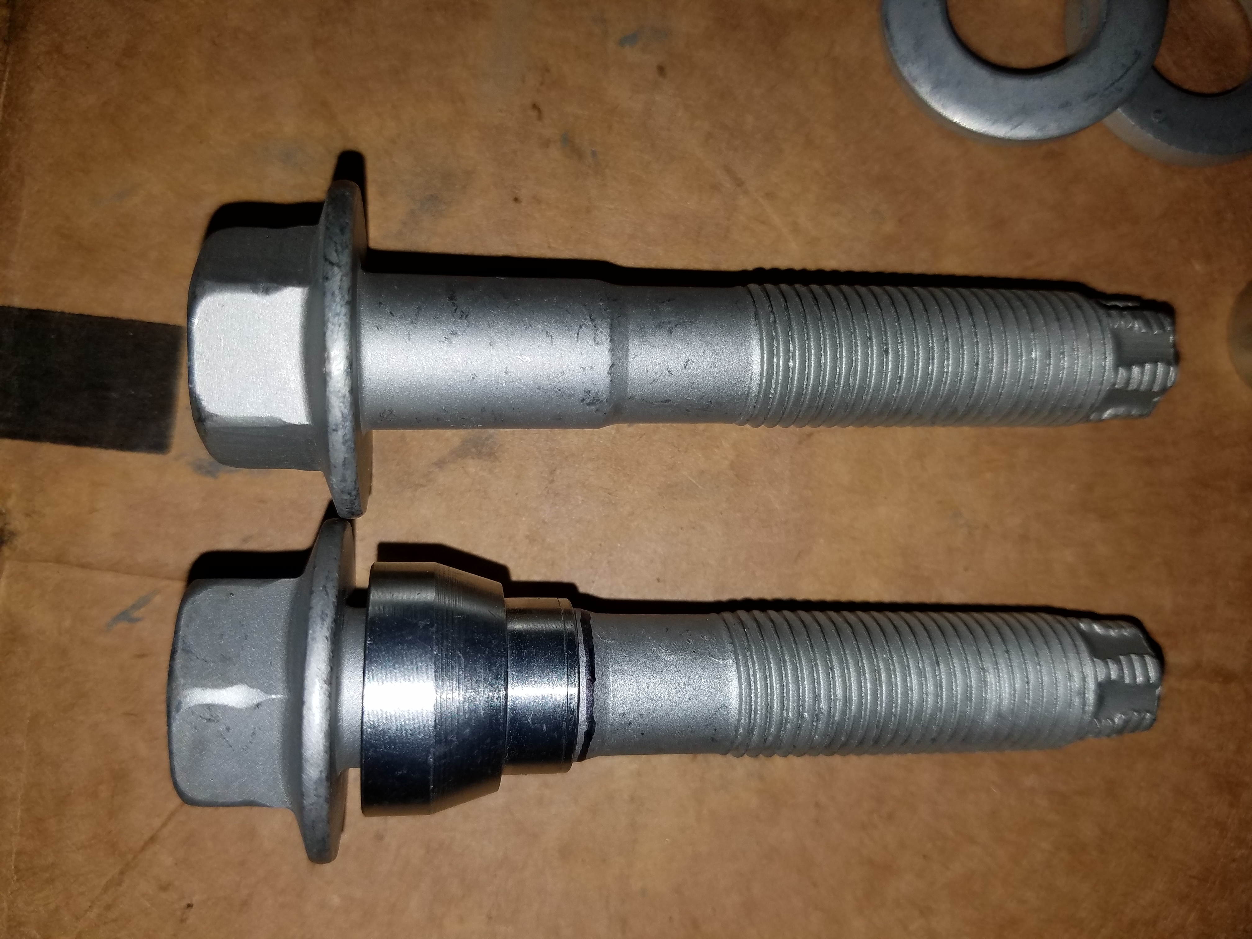

You guys remember my post where I posted a pic of them and said I don't think they are correct and Toyota screwed up for all the years of the Tacoma production?
I'm not sure I will be using the OE bolts ever again at that location. Pretty sure their incorrect shoulder dimensions are why everyone cracks lower heim joint misalignment spacers and they seize up.
These are brand new with one half of the King misalignment spacer on it. The other side of the spacer is on it's own and the load is not evenly spread out. All the force is on one side of the shock and I cant understand why that would be correct. No one Ive asked has said anything about it so that leads me to think no one knows lol

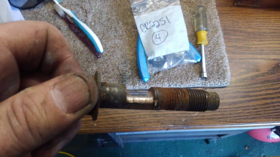

I haven't yet. Still got the new ones sitting in the bag until I can figure out why they stopped the shoulder so short along with 5k worth of TC and King parts. It's half the length I would think it needs to be. I had to cut my old ones out and after some inspection I noticed I had worn through half the bolt when my misalignment spacer disintegrated. Then they fused together with rust from sitting for 3 years. I was amazed at the wear from salt/sand/mud. Pretty sure they were replaced when I did my front end, but my hard rives fubar so all my records are in limbo right now (this idiot never backed anything up & now paying the price).

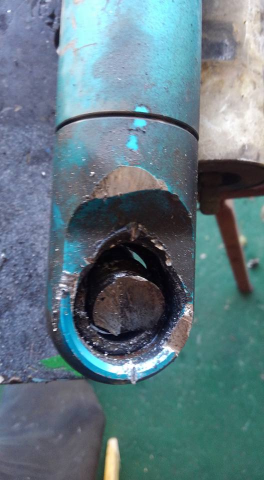

another one bites the dust
and takes out the entire heim hole lol
